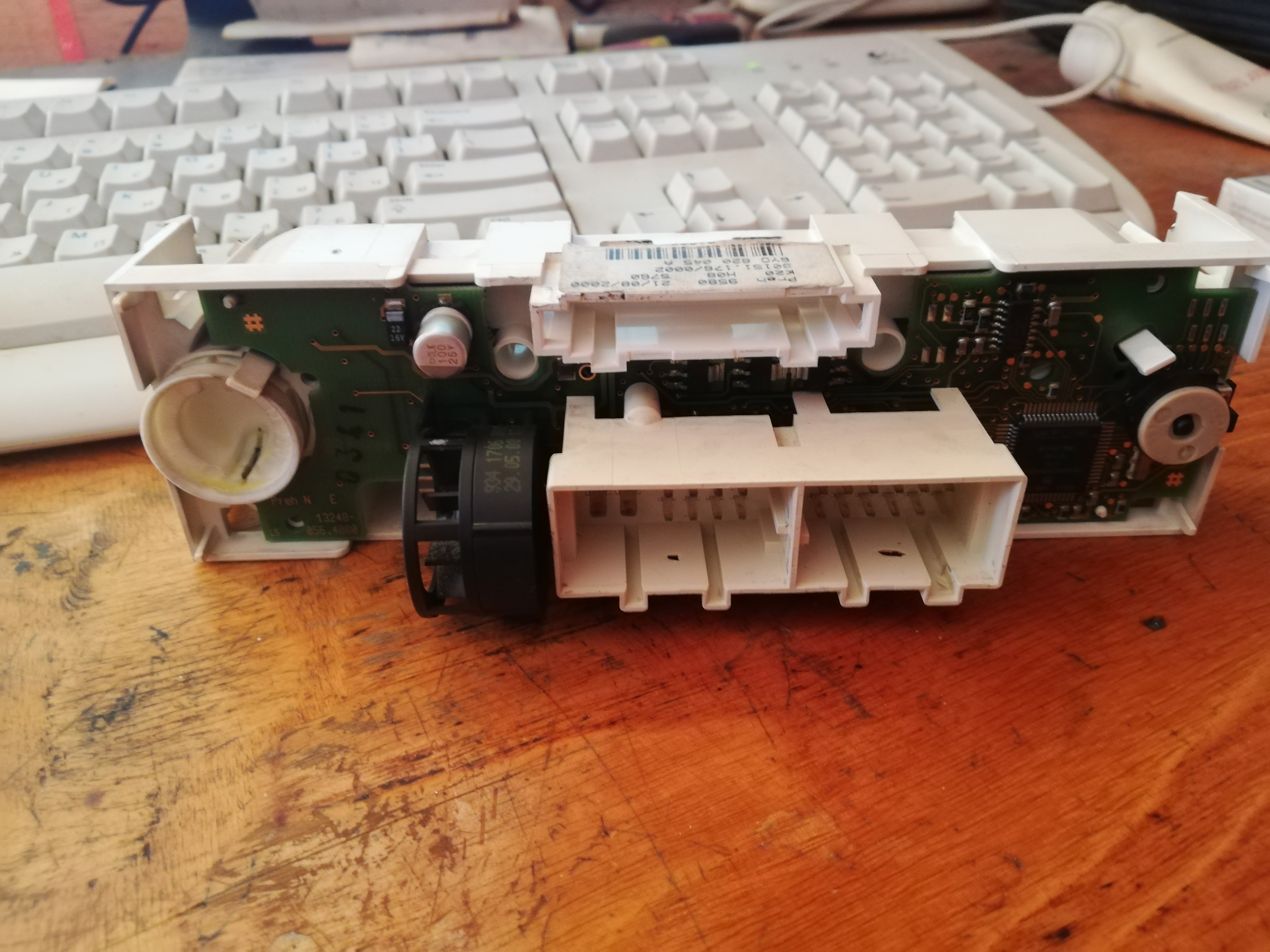

Пичове, незнам какво ви е мнението , но покрай един странен проблем с конзолата на парното, които все още никои не знае от какво е , но аз подозирам реле, установих че маи трябва да сменя N75 клапана, дето ви казах, че чичо ми ме посъветва и вие ми се смяхте. ;)
Цитат
VCDS-Lite Version: Release 1.2
Tuesday, 04 January 2022, 20:25:48:0
Chassis Type: 6Y - Skoda Fabia I
Scan: 01,02,03,08,09,17,19,25,37,44,46,55,56,76
Address 01: Engine       Labels: 038-906-019-AJM.LBL
   Controller: 038 906 019 AF
   Component: 1,9l R4 EDC 0000SG  1110
   Coding: 00002
   Shop #: WSC 13765
   VCID: 5BC9146FDA3D
2 Faults Found:
18043 -  Powertrain Data Bus: Missing Message from A/C Controller
            P1635 - 35-10 -   - - Intermittent
17965 -  Charge Pressure Control: Positive Deviation
            P1557 - 35-10 -   - - Intermittent
Readiness: N/A
Address 03: ABS Brakes       Labels: 6Q0-907-37x-ABS.LBL
   Controller: 6Q0 907 379 D
   Component: ABS/ASR 5.7 FRONT   V00
   Coding: 00188
   Shop #: WSC 13765
   VCID: 3E0FBDFB296F
No fault code found.
Address 08: Auto HVAC       Labels: 6Q0-820-045.LBL
   Controller: 6Y0 820 045
   Component: Klimaanlage        X0760
   VCID: F297D9CBADB7
No Faults Found
  or DTCs not supported by controller
  or a communication error ocurred
Address 09: Cent. Elect.       Labels: 6Qx-937-049-B.LBL
   Controller: 6Q1 937 049
   Component: BORDNETZ-SG.        1S30
   Coding: 09394
   Shop #: WSC 13765
   VCID: F883EBE3CBCB
4 Faults Found:
00906 -  Horn (H1)
            28-10 -  Short to Plus - Intermittent
01598 -  Drive Battery Voltage
            07-00 -  Signal too Low
00778 -  Steering Angle Sensor (G85)
            49-00 -  No Communications
01324 -  Control Module for All Wheel Drive (J492)
Address 17: Instruments       Labels: 6Yx-9xx-xxx-17.LBL
   Controller: 6Y1 919 870 Dv
   Component: KOMBIINSTRUMENT VDO V07
   Coding: 16141
   Shop #: WSC 00222
   VCID: D0D3734303FB
   TMBMS46YX13120310     SKZ7Z0Y0637157
Address 19: CAN Gateway       Labels: 6N0-909-901-19.LBL
   Controller: 6N0 909 901
   Component: Gateway K<->CAN    1S30
   Coding: 00014
   Shop #: WSC 13765
   VCID: F093D3C3A3BB
2 Faults Found:
Address 25: Immobilizer       Labels: None
   Controller: Bit teA dre ssv
   Component: e 17 eingeben
   VCID: D0D3734303FB
No Faults Found
Address 44: Steering Assist       Labels: None
   Controller: 6Q0 423 156 F
   Component: Lenkhilfe           0003
   Coding: 00130
   Shop #: WSC 00001
   VCID: 321799CBED37
Address 46: Central Conv.       Labels: 6Q0-959-433.LBL
   Controller: 6Q0 959 433 C
   Component: 07 Komfortgerát     0002
   Coding: 00259
   Shop #: WSC 00001
   VCID: 3B09B4EF3A7D
1 Fault Found:
01030 -  Central Locking Key Switch; Driver Side; Lock
            29-10 -  Short to Ground - Intermittent
End   --------------------------------------------------------------------------------------------------
Проблема е решен! Проблема е в цялата конзолка с копчетата, има контролер отзад и го играе A/C Controller. За мен от 1.9tdi 1.2htp and 1.4mpi, са еднакви. Проблем остана само че врътката за посоката на въздуха е на 180С  Може би жилото може да се обърне откъм парното , но е много гадно и тясно и скапано място. За мен и така си е ок Part number за моето е 6Y0 820 045 A , смених го с 6Y0 820 045 B Таблото излиза и напред с малко зор (и счупени щипки на кабели). Края на жилото е отдясно под черната пластмаса , малко зАврен нагоре. Това е отговора , на проблема.

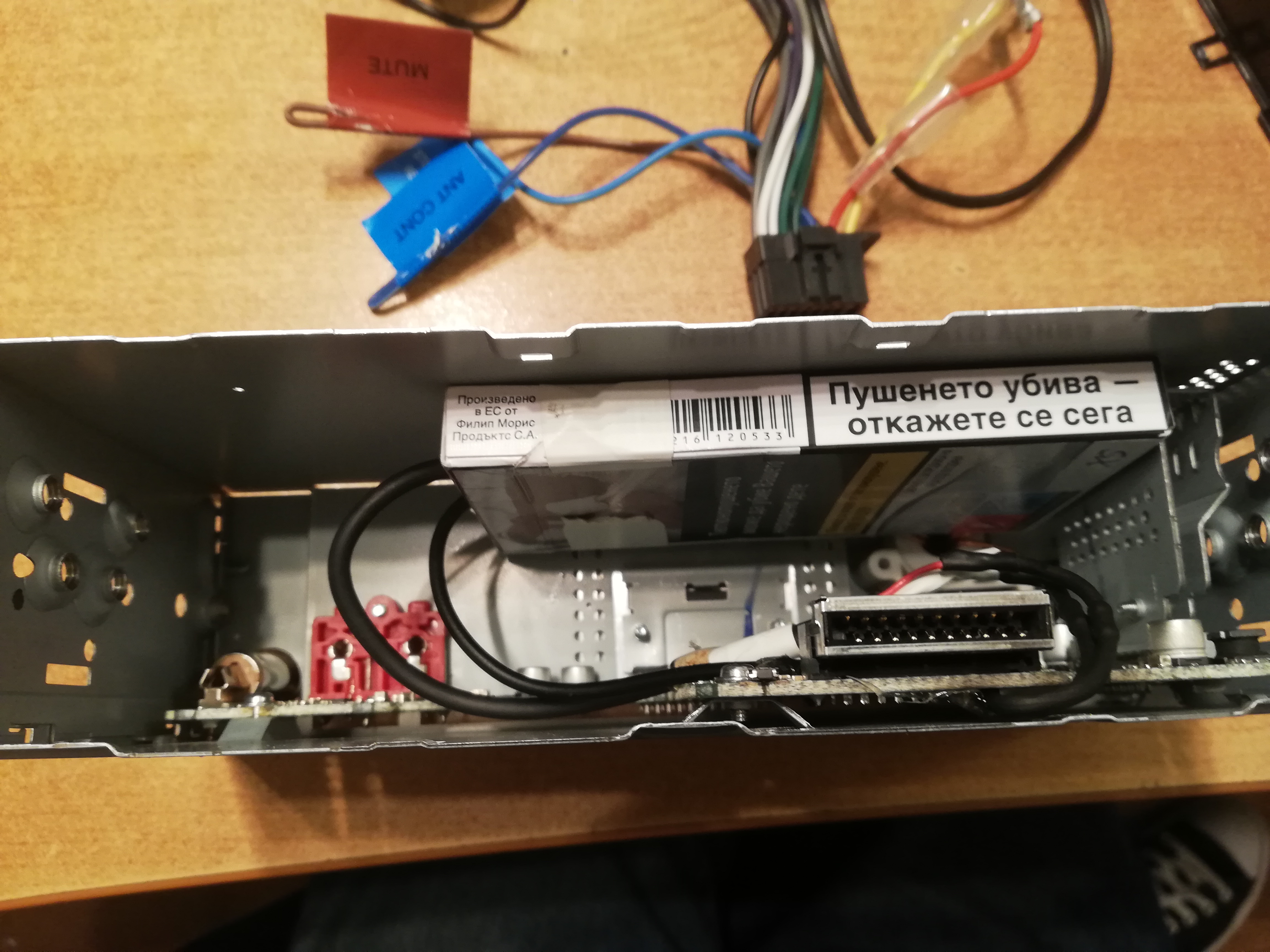

Tази седмица ми върви на модове! Пушенето убива, откажете се сега . Пък аз си имам вече BT модул. :)
